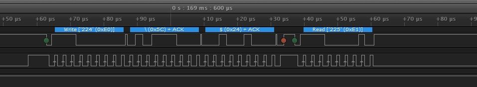

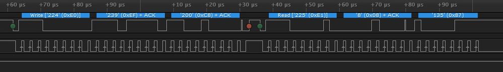

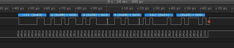

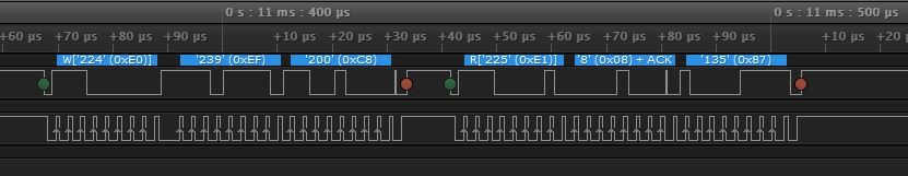

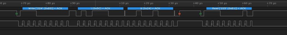

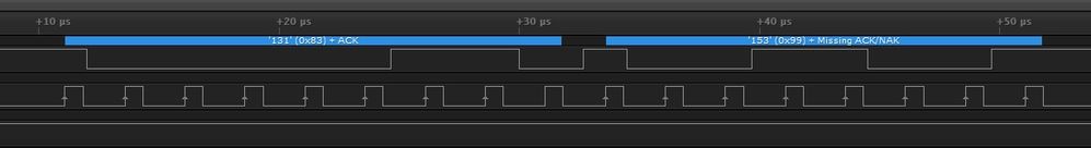

For some reason I need to rewrite I2C functions from HAL to LL. As I aim to achieve good power consumption results, I decided to use DMA and IT in order to save as much resources as I can. There is all ok with writing data (HAL1 and LL1 pictures) but I'm struggling to receive data from slave using DMA and LL drivers. My observation - after read commands there is no STOP condition (HAL1 vs LL1 again) after transmission and instead 6 bytes I'm receving only 2 (HAL3 vs LL3). I'd appreciate any suggestions to solve the issue. I base on I2C DMA LL example.

HAL1:
LL1
HAL2
LL2
HAL3
LL3
