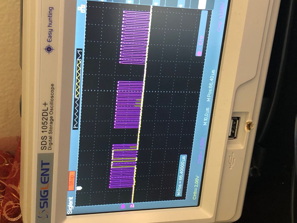

I am trying to talk to a Winbond W25Q64 SPI Flash and it seems to write data ok but for some reason the call to do a SPI Read actually forces it to clock16 bits - which is wrong. It is set to 8.
I do a HAL_SPI_TransmitReceive to send a 0x9F to read the 3 byte ID. I get the first byte straight back according to the trace. But then I call HAL_SPI_Receive and it still seems to clock 16 bits (and seems to call TransmitRecieve) internally
Any ideas?
The trace is the clock and then the MISO line. Code Is below - I am just calling the Flash_ReadID and it returns all zero. The initial function is below that
