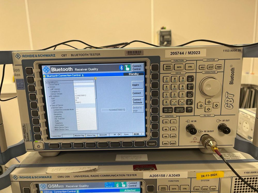

I need a DTM firmware for BlueNRG2 which works wirelessly with the equipment shown in the image. I wonder if ST provides their customers with such a firmware?
thanks,
2023-03-09 7:00 AM
I do confirm DTM image provided in BlueNRG-2 SDK can be used for such purpose.
