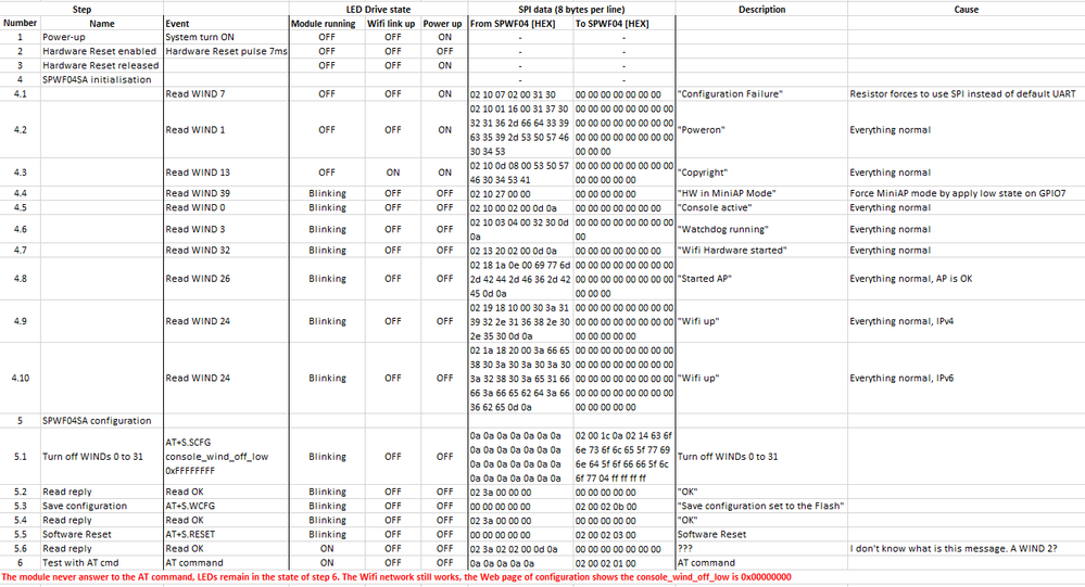

2017-11-28 7:56 AM
Don't worry for the micro, I got it
I made you the step-by-step initialisation as implemented in my program, including LEDs' states:
The SPWF04SA no longer assert the nHostIRQ line. I tried with different value for console_wind_off_low such 0x20000000 but it is still the same behavior.
It seems, it is a problem with the Reset command. Do I use it correctly?
Thank you for your help, I really appreciate it
