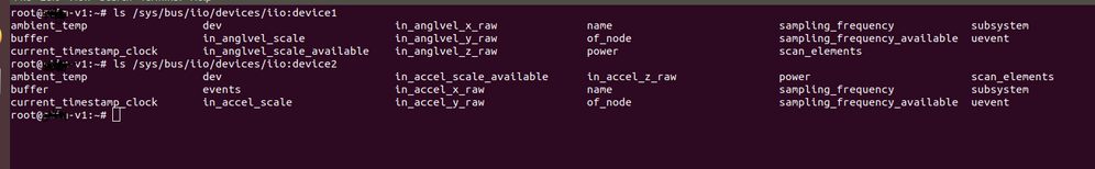

I have a custom Linux board with a lsm6dsl module on the platform. The driver has been ported and I can read the Accelerometer and Gyro raw data from the Linux usersapce sysfs file entries. an interrupt line from the lsm6dsl module is connected to the main processor.
I wonder if it is possible (and How) to configure to lsm6dsl module via Linux sysfs entries to generate the interrupt once the module is in certain orientation or when it detects a shock wave. image shows available sysfs entries for accelerometer and the gyroscope.
