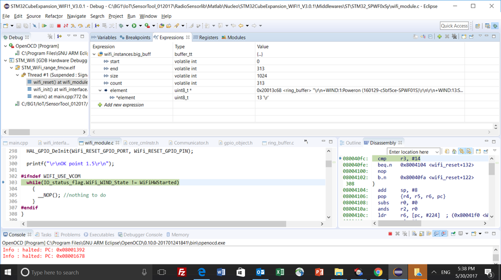

I just used the Eclipse & OpenOCD to see the ring_buffer info
and I can see that
The elements inside the wifi_instances.big_buff does have all the WIND:1:Poweron msg, etc..
So does it mean that somehow the UART path is broken due to mix build with mbed UART HAL driver and so those msgs cannot be popped up in the TeraTerm?!
Or as I suspect that my LinkerScript.ld cannot handle that correctly?!

And I set more breakpoints to see when the ring buffer got to have the elements filled in
and I found that it's only when the program is running into the wifi_reset() but it would not come out of the wifi_reset() because it is trapped in the while() loop inside the wifi_reset().
Hope that you will have better idea on where to debug next...
