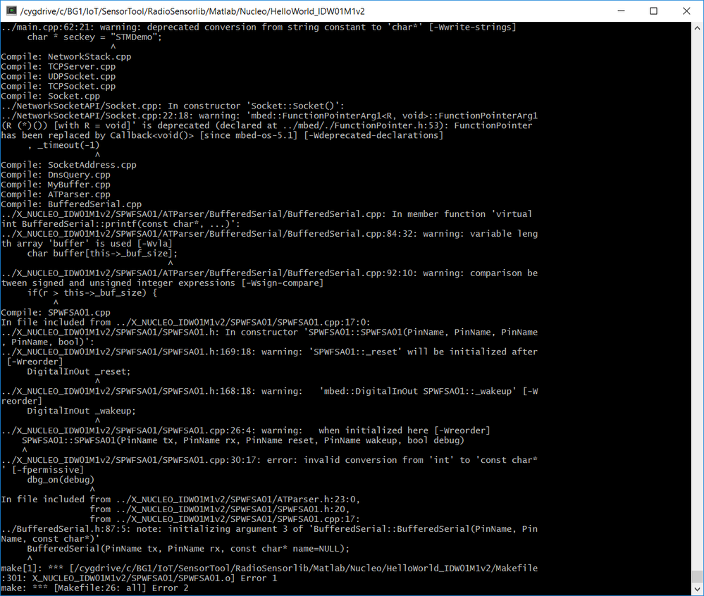

Therefore, I used
https://developer.mbed.org/teams/ST/code/HelloWorld_IDW01M1v2/compile
to trace out all the files that got compiled by the online mbed compiler and then downloaded all the related *.cpp/*.h to mimick the same.
However, it still doesn't work well as I still have the following compile error which I cannot figure out at all?!
I
I don't know why the codes in SPWFSA01.cpp would cause this invalid conversion from 'int' to 'const char*' error...
SPWFSA01::SPWFSA01(PinName tx, PinName rx, PinName reset, PinName wakeup, bool debug) : _serial(tx, rx, 1024), _parser(_serial), _reset(reset, PIN_OUTPUT, PullNone, 1), _wakeup(wakeup, PIN_OUTPUT, PullNone, 0), dbg_on(debug) <=== Problem HERE?!{ _serial.baud(115200); // LICIO FIXME increase the speed _parser.debugOn(debug);}Any idea please?!

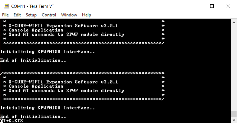

4. After I reflashed this Project.bin to my F411RE board, I would get:-
It looks ok for initialization
but when I type ''AT'', no ''OK'' response. Type ''AT+S.STS'', no response at all.
Therefore, something is still wrong inside
while (1)
{ wifi_vcom(); } }in main.c
However, I have no more clue on how to debug from here anymore!
Please help if any suggestion.

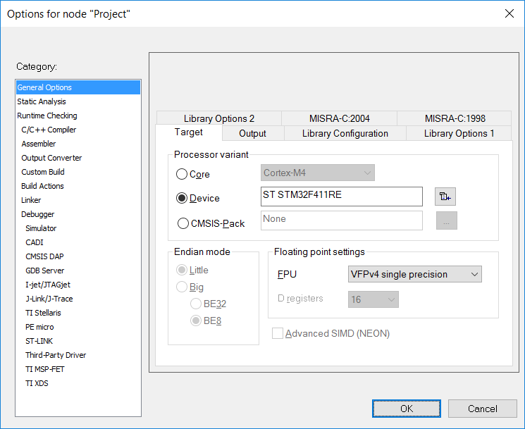

I modified the IAR Project General Setting like this:-
but not sure if any other details I may have missed?!

Hi Robert,
here is a quick way to port to F411RE which I tried.(of which you have already done some steps)
Let's take the example of the WiFi_VCOM Application and toolset IAR (EWARM folder).
1. Inside EWARM, copy the 'STM32F401RE-Nucleo' and rename to 'STM32F411RE-Nucleo'
2. Copy two files: 'startup_stm32f411xe.s' and 'stm32f411xe_flash.icf' inside above created folder (You can find these files in examples of STM32Cube_FW_F4_Vx.yy.0 driver applications downloaded from the st website)
3. Open the project.eww and then open Project Settings
4. In 'General Options' tab, select correct device name: 'ST STM32F411RE'
5. In 'C/C++ Compiler->Preprocessor' tab, change 'Defined Symbols:' value: STM32F410xE to STM32F411xE
6. In 'Linker->Config' tab, select correct linker script file 'stm32f411xe_flash.icf' (already copied to home directory in previous step)
7. In workspace project file view: Example->EWARM-> select correct startup file: '
' (already copied in home directory in previous step)8. Build Project-> should be clean without errors.

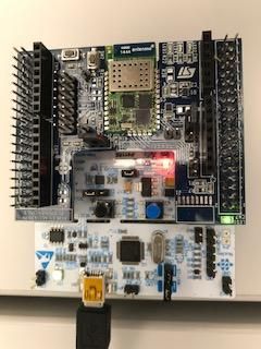

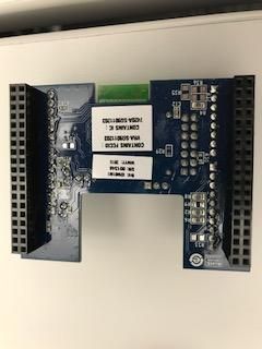

Again, mine is with:-
#ifdef USE_STM32F4XX_NUCLEO
#define CONSOLE_UART_ENABLED#define SPWF01 => for X-NUCLEO-IDW01M1?!//#define SPWF04 => for X-NUCLEO-IDw04A1?!#endifAnd I also tried to capture my setup photos for you to check here please.
Thanks & Best Regards,
