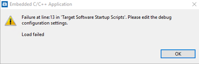

Hi
I am trying to debug with the IDB007V1 dvelopment board and a STLINK V2 but the debug process fails at the FLASH download.
I have tried the sensor and hello world demonstration programs with the same result.
Any help to start debugging would be appreciated!
Patrick
#bluenrg-1 #steval-idb007v1

2017-11-15 4:48 PM
I want to run debug, not just program. How do I do that?
Thanks
Patrick

2017-11-21 1:41 AM
I had this problem too with latest version of TrueStudio.
I just ended up using another solution for build and flash...
So there is no easy way, for now, to evaluate these modules for beginners.

2018-06-11 7:04 AM
Hi, you can debug in 'Eclipse like IDEs' after you properly configure your project settings. In original eclipse I'm able to debug with ARM MCU plugin for Eclipse and using OpenOCD.exe compiled by ST + use configurations file for openocd also from ST... You can find everything in 'BlueNRG-1_2 DK 2.6.0'.
