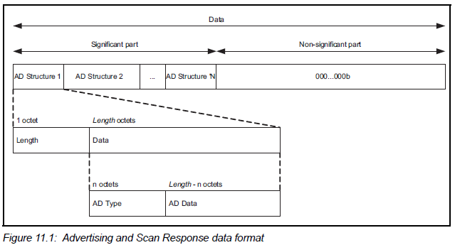

The complete advertising data (or scan response) is supposed to be in *Data, in the followed format:

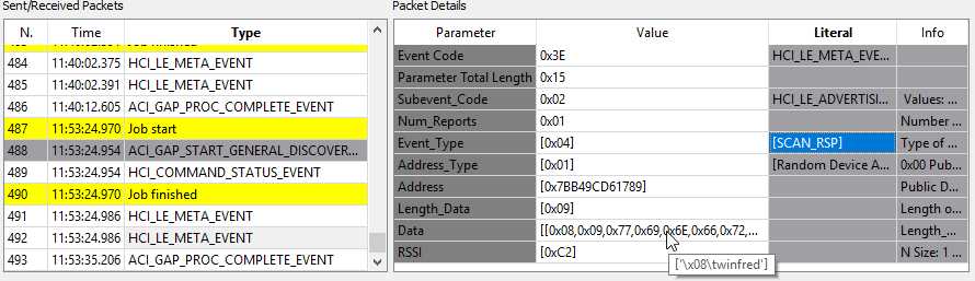

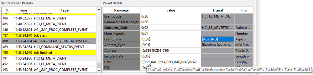

I replicated the advertising more than 31 bytes with "nRF Connect", the follow screenshots show data separately in two events:

Yes. The second advertising report will have Event_Type equal to 4 (Scan Rsp), which is actually the response to the active scanning.
The primary advertising report may have Event_Type from 0 to 3 according to advertiser settings.
It is the beacon (advertising data) sent periodically every advertising interval.
