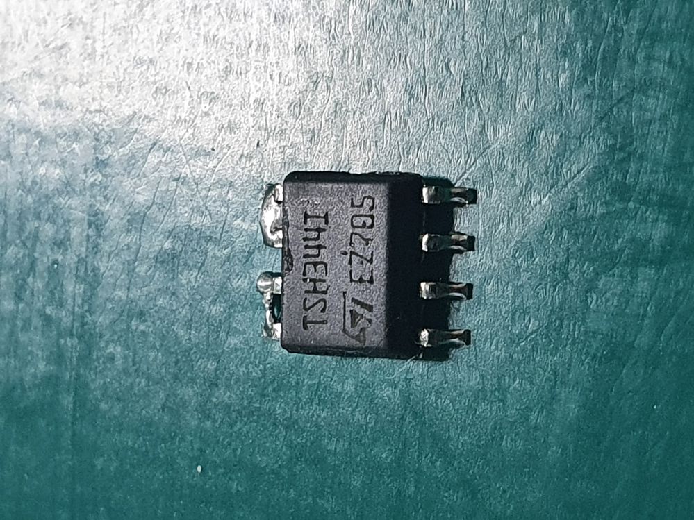

Hello.
It is a Korean company called LIG Precision Technology. I have a question about TSH344IDT product.
I checked the document stating that the marking information of this product is TSH344I.
But I'm curious about the marking information about EZxxx.
Also, please let me know when the production was stopped.
Thank you.

E: additional information
Z: assembled in ST Bouskoura
7: assembled in year 2007
05: assembled in fifth week of that year

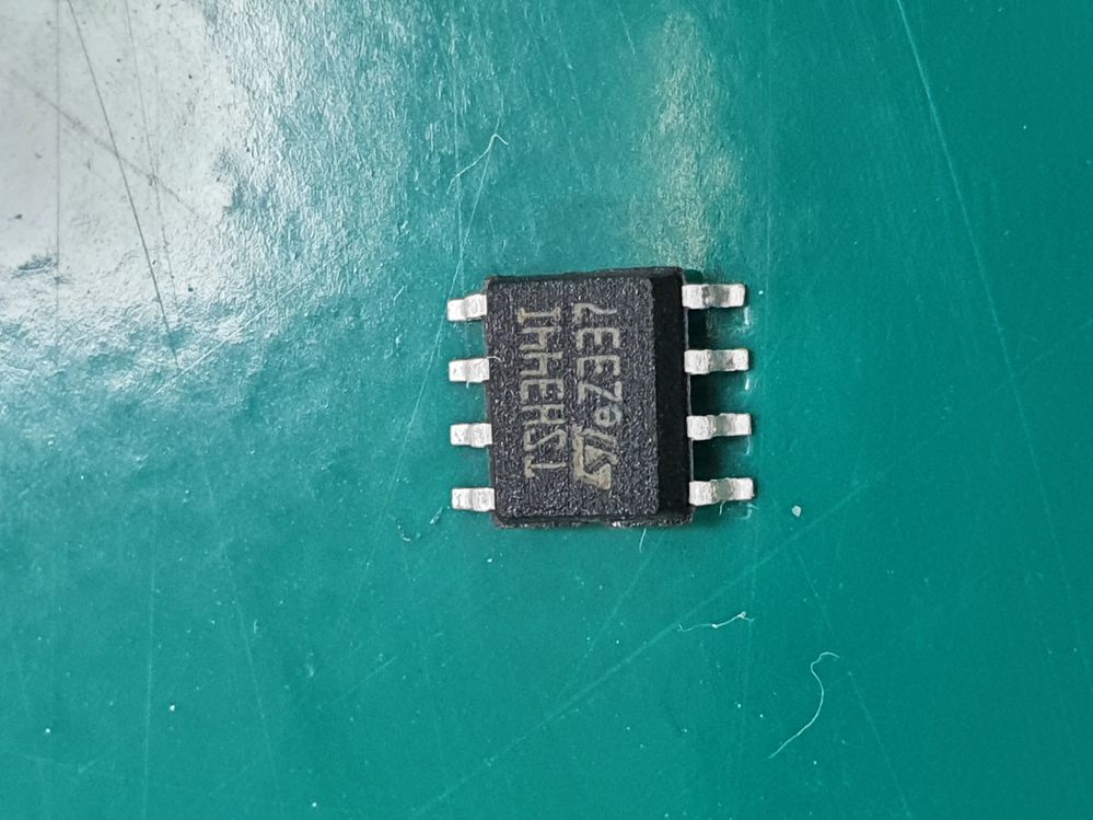

The question of numbers has not been answered. The number of products we have can be interpreted as being produced in the future when approached with the answer. Can I know the production year and month by number?
We also have products marked with EZ845 and EZ551 unexpectedly in the attached picture. All markings are laser-marked.

My mistake. The respond has been modified accordingly.
The four letters mean: PYWW

For the latest 3 letters YWW
Y = the last digit of year of assembly
WW = work week of assembly
Therefore,
705 means that it can be produced in 2007 or 2017, week 05
I supposed 2007 but actually it can also be 2017.

337 means it was produced in 2013 week 37
