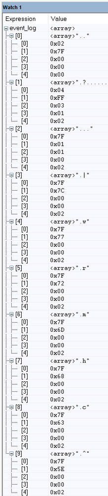

However, the initial response is not correct after reset - compare with chapter 3.5 Test procedure in the AN4494.
The first message after reset is correct, but the response is invalid from the 2nd reply.
04, FF, 03, 01, 00, 02 (<- should be 01)

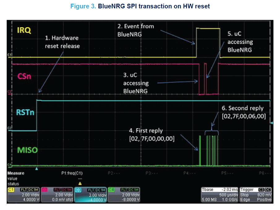

According to the application note AN4494, some event messages is sent by the bluenrg after reset.
(The chapter 3.5 Test procedure demonstrate the messages after reset.)
Except for the first event message, I cannot obtain correct values.
https://www.st.com/resource/en/application_note/dm00116738-bringing-up-the-bluenrg-and-bluenrgms-devices-stmicroelectronics.pdf
This is my captured messages after reset.

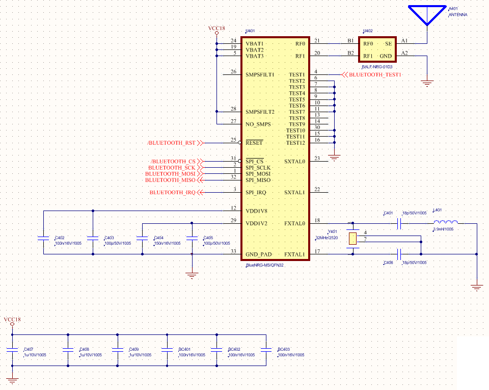

I referred the sensortile schematic, at first. so I attach the 32MHz crystal to the bluenrg.
It does not work correctly, so I change the clock source same as development kit's - steval-idb005v1d.
But the message does not change.
