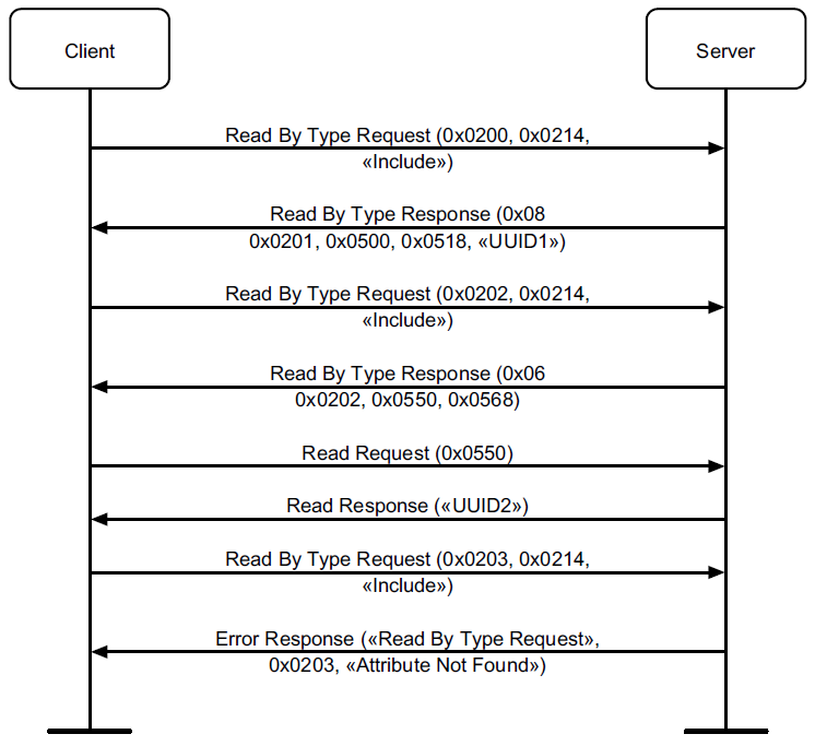

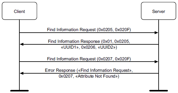

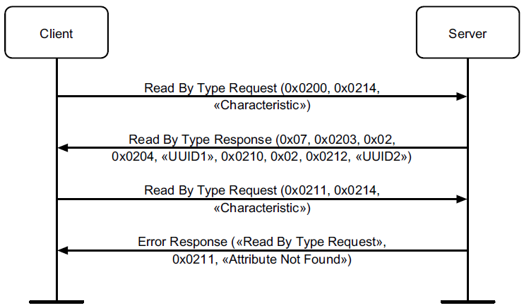

An attribute handler plus some offset is another attribute handler.
There is no magic number here. The assigning of the handlers can vary depending on that GATT server.
The implementation with BlueNRG-2 (stack) may not be the same as others.
As explained in the Core spec:
The Attributes are ordered by increasing Attribute Handle values. Attribute Handle values may begin at any value between 0x0001 and 0xFFFF. Although the Attribute Handle values are in increasing order, following Attribute Handle values may differ by more than one. That is to say there may be gaps between successive Attribute Handles. When the specification requires two attribute handles to be adjacent or for one to immediately follow one the other, such gaps are still permitted and shall be ignored.
Please use "Discover All Characteristic Descriptors" sub-procedure In case you'd like to know what the descriptors are:
