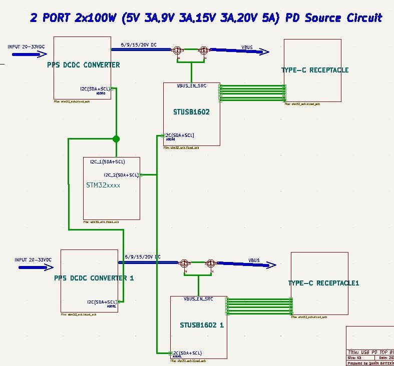

Can we use stusb1602 with ı2c controlled pps converter and STM32fxx MCU. You can see the block diagram on the attachment.
We will control the STUSB1602 registers viaI2C to get request pd voltage and current simultaneously. After that we will set the pps converter via I2C to the request voltage. Can we do that?
Are we need SPI communicatin to the STUSB1602? İs enough just use the I2C communication stusb1602 to the MCU?

Hello Sahin
STUSB1602 needs both I2C and SPI.
BMC data need SPI while TypeC uses I2C.
To control DCDC depending on request from Sink, you can use our SW examples.
compilation switch _GPIO_FOR_SRC gives you where to change your supply output thru GPIO but can be easily replaced by I2C command.
Best regards
