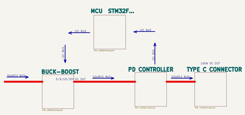

Hi Benoit,
Thanks your answer, isn't possible? to get the device ,which is connecting the port, requested voltage from STUSB4761 via I2C communication by MCU. After that set the buck-boost voltage to the requested voltage by MCU. I have PPS Buck-Boost converter can set via I2C.
like flow that on the attachment.
İf it's not possible with STUSB4761 , which pd controller can I use from ST pd controllers.

Hi Sahin,
understand your request, but to achieve fast enough voltage transition (according to USB PD requirements), an interrupt and a dedicated register map are required to quickly drive the Buck-Boost according to USB PD negotiation. While this IC is optimized to autonomously negotiate, regulate and monitor voltage, without MCU supervision. This is a good fit for an AC/DC application, but not in your case unfortunately.
Another option is probably to operate the USB PD stack from the MCU directly. Please check our STM32 offer with USB PD support.

Hello Sahin,
We can also propose you another solution with an STM32 with USB PD stack embedded (UCPD peripheral) such as STM32 G0, G4, L5, H5, or H7 and a TCPP02-M18 for source solution.
Please find a full exemple based on STPD01 buck.

Hello Sahin
If you want to design source >60W with DCDC, STUSB1602 + STM32 is suitable.
You can select SRC_ONLY project and use _GPIO_FOR_SRC switch to control your DCDC.
