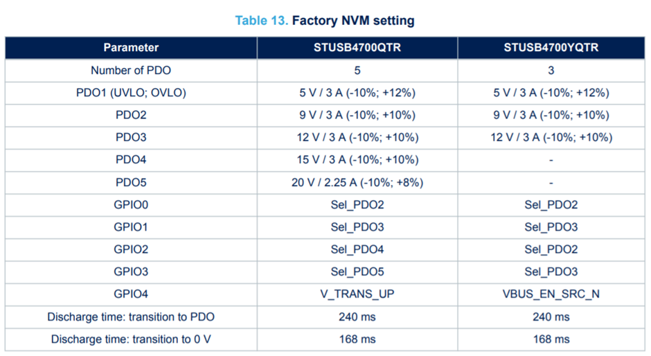

  2. As part no. we used is STUSB4700YQTR, it is an automotive version and supports only three PDO profiles, thus IC’s Pin No. 15(GPIO3) and IC’s Pin No. 14(GPIO2) should not be connected to the Resistor divider, i.e. it has to be No Connect, once the trace was cut negotiation started happening and it started working, Below is the snip of the STUSB4700's datasheet showing supported PDO profiles.
