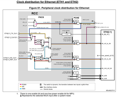

Then you should check that ETH1_CLK_SEL value is well at 0 (Gates are manipulated by properties in device tree). The clock tree is documented in the RM (see below an extract):
Do not hesitate to check too at this wiki article that can help: https://wiki.st.com/stm32mpu/wiki/Ethernet_device_tree_configuration

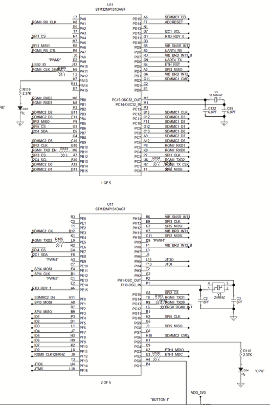

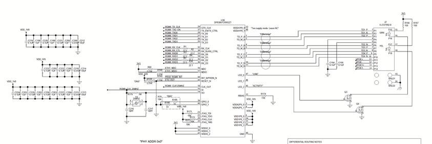

Here is schematic:
SoC:
Phy:

Hello @devinschubert14 ,
I begin to review the information you gave above. I just begin but I already see that the interruption described in the DTS under mdio node looks wrong isn't it ?
According to your schematics, it seems that the interrupt is coming on PG12 but the device tree mentions PG11. PG11 looks like an unconnected pin.
[Edit: I see you declared it in pinctrl directly, but I do not understand so what is this interrupt declared in mdio node]
Kind regards,
Erwan.
2025-10-07 4:33 AM
@devinschubert14 ,
I took a look at your pinctrl and compared with your schematics, OK for most of pins but I am surprised. I do not see the ETH_RGMII_RXCLK. It should come on PA1 according to your schematics and is mandatory to get a correct setup.
Kind regards,
Erwan.
