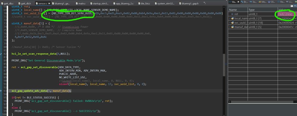

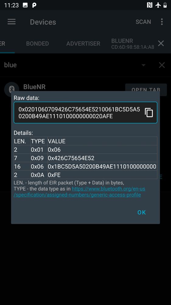

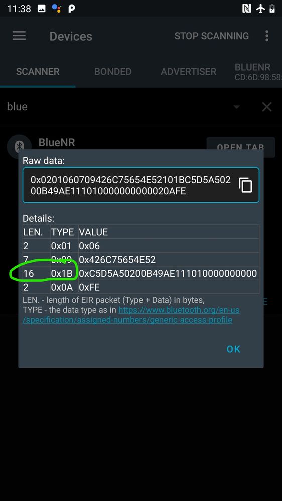

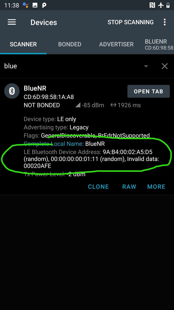

2022-07-21 11:02 AM
@Sebastien DENOUAL Thanks for the suggestion. I am using the example you suggested and I still see incorrect behavior. The uuid I am trying to add to the advertising packet is 000000000001-11e1-9ab4-0002a5d5c51b which is the one used in the BLE Sensor APP example code (HW service)
I don't think the aci_gap_set_discoverable() has been verified with a uuid 128 list. The function or some underlying call does not account for the AD Type to be inserted just like the local_name variable. I tried 3 things below and each time the advertising packed was either nor formed or formed incorrectly.

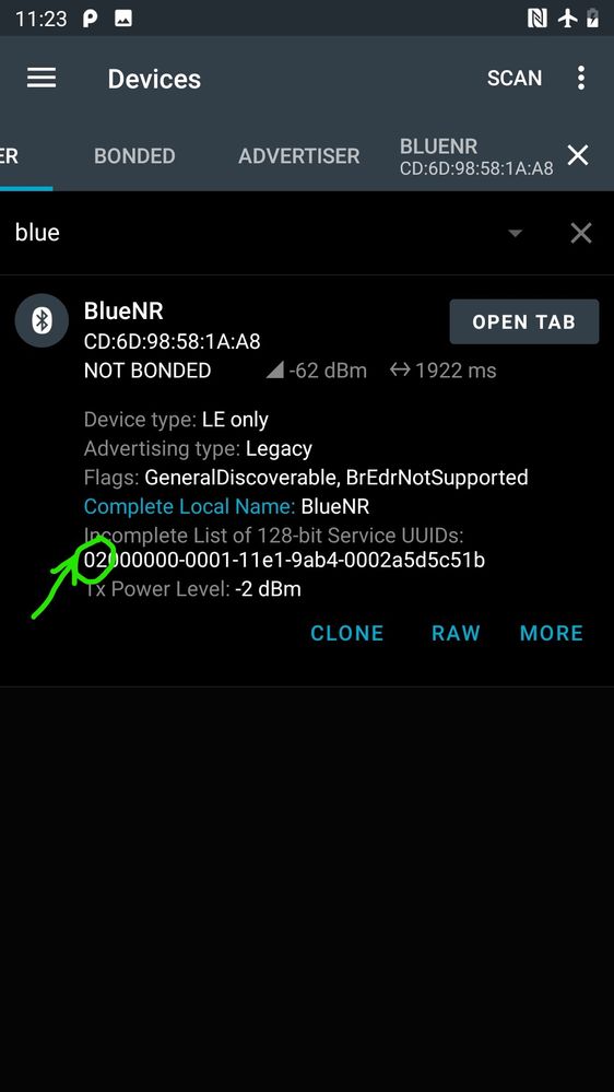

2022-07-21 9:19 PM
@Sebastien DENOUAL I was able to get the service list to work with a 128 bit uuid and I did have to declare 17 octets for the function to work. To make it work I had to reduce the size of the local advertised name by about half.
Is there a way to increase the size so I can have a longer name and a 128 bit UUID. I have seen other bluetooth 4 chipsets support this feature so is it a configuration issue?
