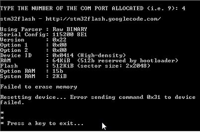

I have some problems regarding firmware update. When I try to update firmware via serial link, I obtain this message:''Error sending message 0x31 to device'' as show also in the image:2016-03-30 2:25 AM
Ciao Stefano,
seems FLASH is corrupted...Can you please try an update through standard (GUI-based) FlashLoaderDemonstrator tool? Let me knowjerry2016-03-30 3:34 AM
