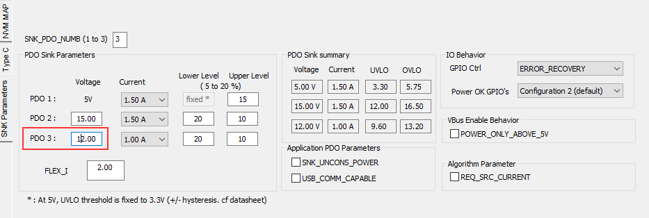

It can be configured directly in STSW-STUSB002 GUI :
0693W000005AGuAQAW.pngThen, please remember to write the modification NVM.
The corresponding content is at offset 0xE1 and 0xE2 -- SNK_PDO_FLEX2_V.
To set the voltage to 12V:
  • offset 0xE1 = 0xF0
  • offset 0xE2 bit[1:0] = 0b00
Which means SNK_PDO_FLEX2_V[9:0] = 0x0F0 = 240
