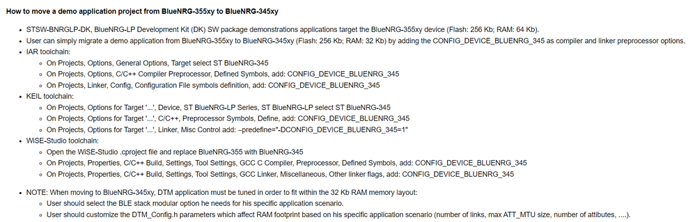

To build DTM for BleuNRg-345, you need reduce RAM footrpint to fit into 32KB memory : see extact below from SDK doc (4) Design & Bringing Up custom BlueNRG-LP PCB)
This can be achieved by changing preprocessing option of your DTM project.
For regional certification, you can reduce number of Advertising sets and number of maximum simultaneous connection.
NUM_ADV_SETS_CONF=1
CONFIG_NUM_MAX_LINKS=1
et me know if it solves your issue.
