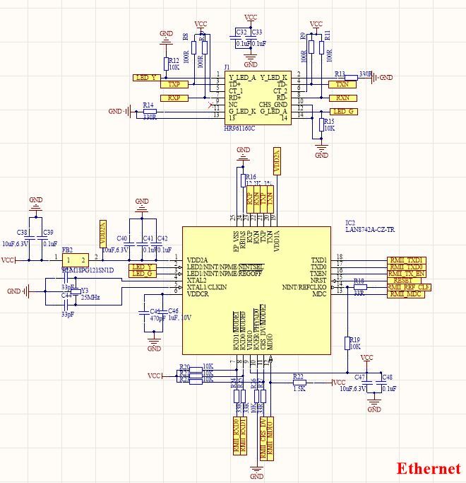

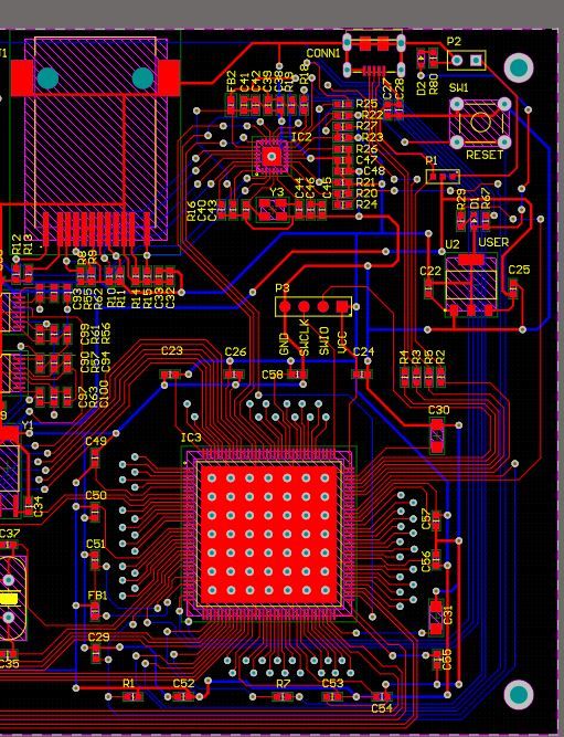

Now, I drawing STM32F746ZG with Ethernet LAN8742A like picture below.
I don't know why when I testing it not work.
I made sure soldering ok. And code I already test on NUCLEO-746G kit. it work well.
Could you give advice for this?
