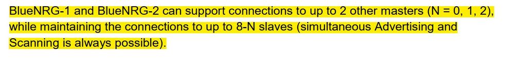

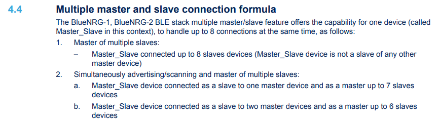

@rsilva : ARami.1 is using BleuNRG-LP whereas you are using BleuNRG-2.
BlueNRG-2 is limited up to 8 simultaneous connection as per below :This is an extract from PM0257 : BleuNRg-2 BLE stack programming manual - section 4.4

Hi @Sebastien DENOUAL thank you for your input, I am aware of these limitations and I am using 6 simultaneous connections.
With your input on the repeated attempts feature and some tweaking in connection parameters we achieved more stable connections now.
