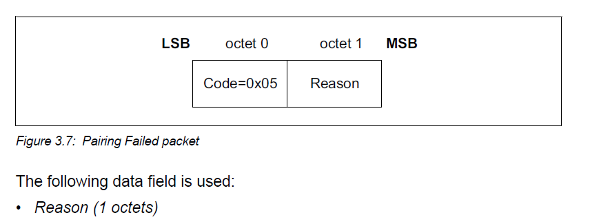

2022-05-31 6:32 AM
Hi @rsilva ,
The BlackList mecanism is known as "Repeated Attempts" (Feature Exchange) in BLE spec.
This is available in BLE spec (section 3.5.5 - in spec 5.2 )
Reason codes are described in table 3.7 :
Idea is to add this device in Blacklist until a timeout. The timeout for black list increases each time there is a failure, till a maximum of 135 seconds. After this period, you should be able to pair again.
Regarding the BLE_STATUS_NOT_ALLOWED, more difficult to conclude as many scenarios may lead to this error . Interesting here to understand if issue is 100% reproducible at 1st connection (means probably a parameter issue or bad order in commands). Is this happens only on multiple connections, but not 100% reproducible,... timing issue is one hypothesis among others.
Regards,
Sebastien
