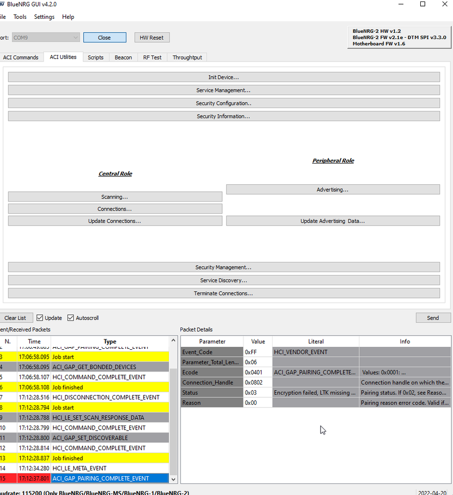

I'm using for evaluating purpose two NucleoL4 boards w/ X-NUCLEO-BNRG2A1:
Everything is working as expected: NimBLE is able to scan the peripheral / connect to it / execute pairing.

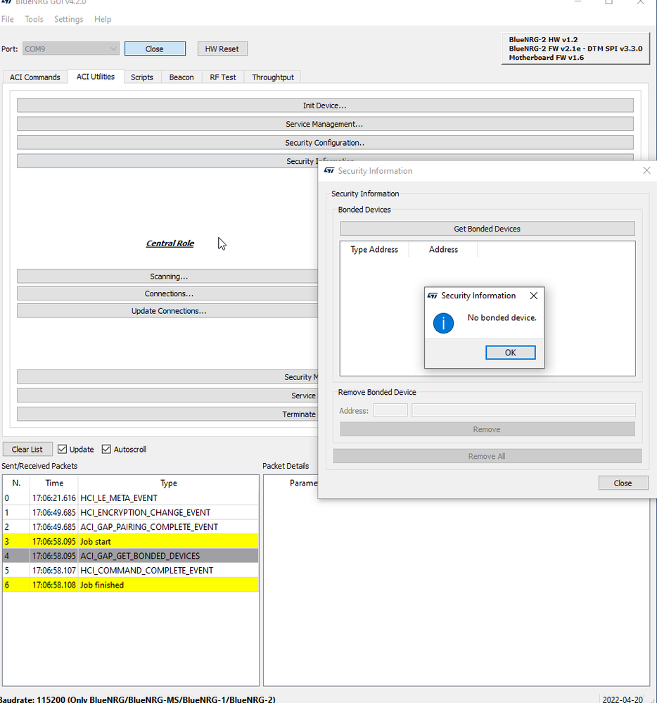

The problem is that after bonding succeed, if I check bonded devices list (on the board running the peripheral role), this is always empty, as shown in the image.
As result, if I try to reconnect w/ LTK key just exchanged I got pairing error due to encryption failed.

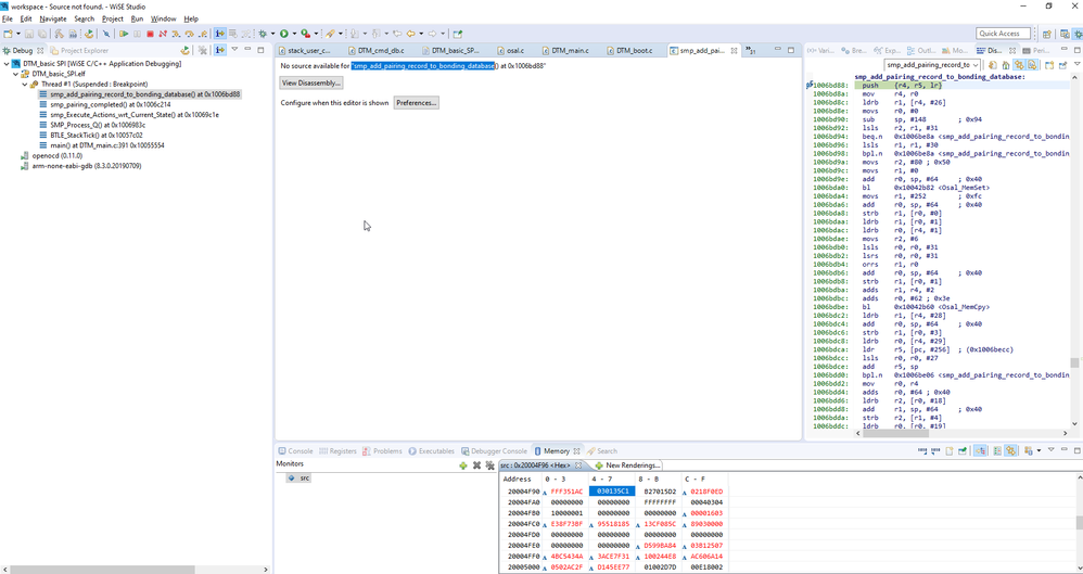

an update about the problem: the function ""smp_add_pairing_record_to_bonding_database" is correctly called, as shown in the image, but when calling "get_bonded_devices" the list is always empty.
Any suggestions?
