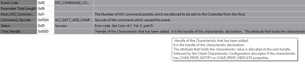

Hi All,
I think I was somehow managed to decipher the logic carried out in the Read-Eevent callback. I don't find this information anywhere neither in the BlueNRG-SDK(UM1865) nor in Programming Manual(PM0237).
But, fortunately I came across some useful information on a tool-tip-baloon on BlueNRG-GUI Desktop application.
The words ''next handle'' explains why the increment was done before the comparison.
I'm pretty sure that this is not something particular to Bluetooth Core specification. This should be something unique to BlueNRG-SDK. It will be really good if the documentation is updated with the relevant information as well.
