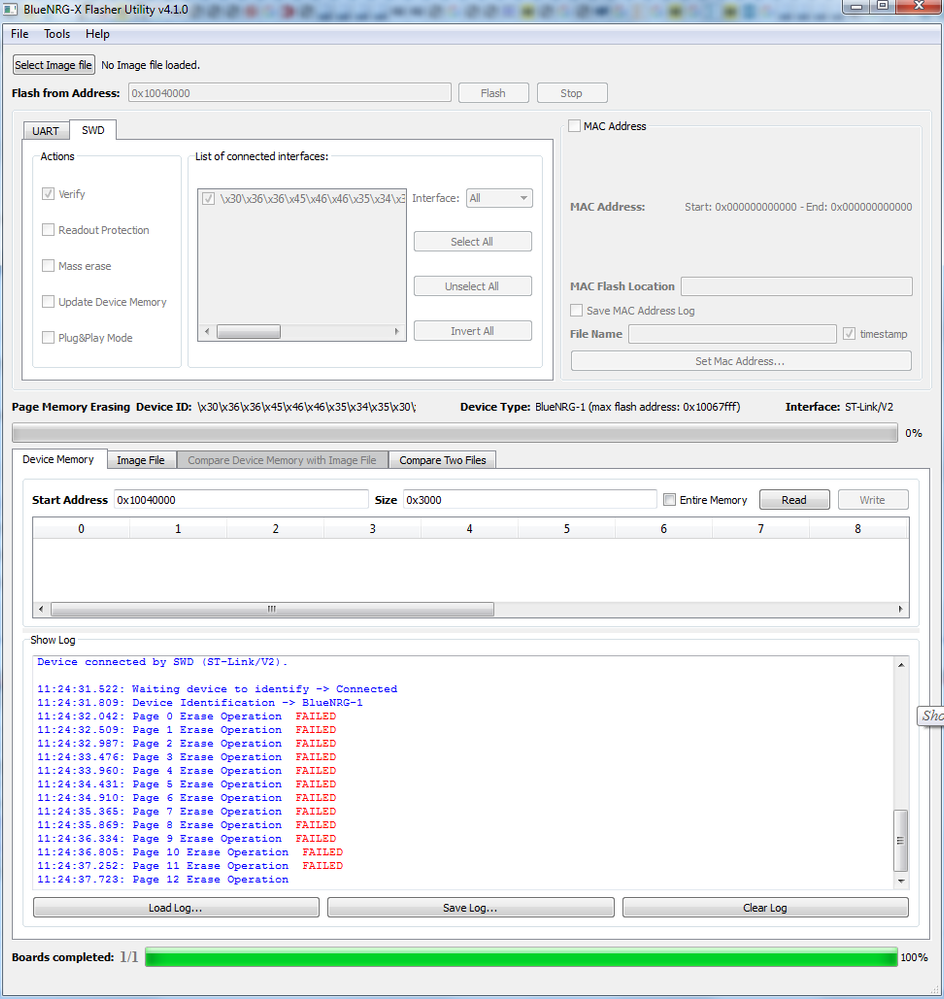

2021-01-28 7:38 AM
I know it's old, but were you able to solve this problem? I'm facing the same now
2021-01-28 5:02 PM
Please try to erase the flash firstly.

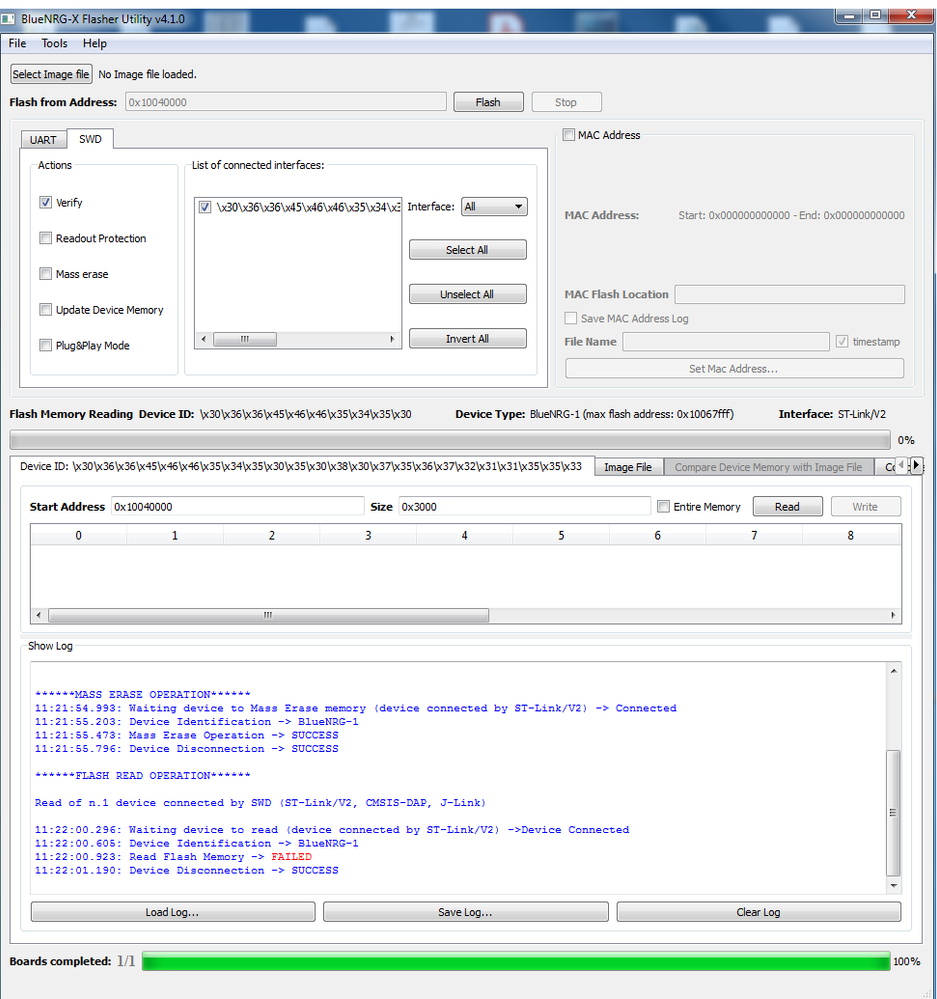

2021-01-29 6:28 AM
Thanks for the response. I tried to erase it with Keil and BLUENRG-X Flasher, it says that it erased successfully, but it still can't be read
Besides, if I try to erase by pages, it fails, so I believe it can't actually erase the chipI've also tried resetting with BOOT in high, but there were no differences so far
