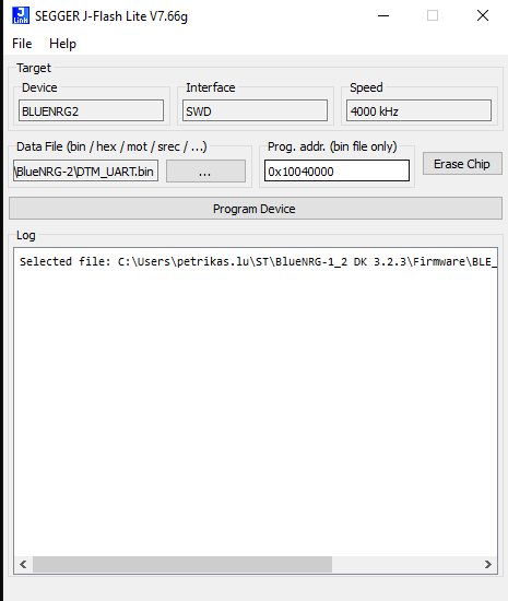

I have picked up the binary file that I have flashed via SWD using J-FLASH Lite with J-LINK:
I have picked up binaries from:
ST\BlueNRG-1_2 DK 3.2.3\Firmware\BLE_Examples\DTM\BlueNRG-2\DTM_UART.bin
I have also tried the STEVAL firmware :
ST\BlueNRG-1_2 DK 3.2.3\Firmware\BLE_Examples\DTM\STEVAL-IDB008V1M\DTM_UART.bin
