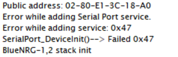

I use the sample program to copy a program, but it doesn't work, the error code is 0x47

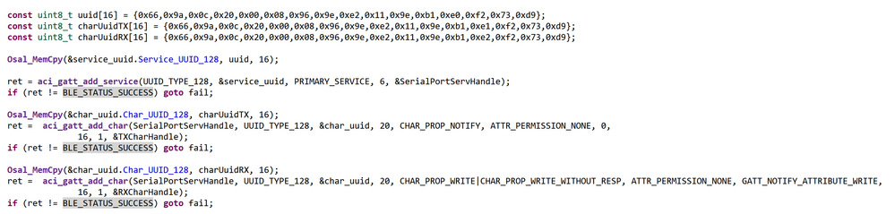

I use the ST supply version 3.2.2 of the "BLE_SerialPort_Master_Slave" project. I try modify gatt_db.c add new characteristics UUID,
but did not succeed, system appears error code is "0x47",
After I reference the "PM0257" document and found I do not modify several parameters in SerialPort_config.h, such as
"NUM_APP_GATT_SERVICES",
"NUM_APP_GATT_ATTRIBUTES",
"ATT_VALUE_ARRAY_SIZE",
other the "gatt_db.c" service API "aci_gatt_add_service" fourth parameter must write the right value can create UUID and work on.

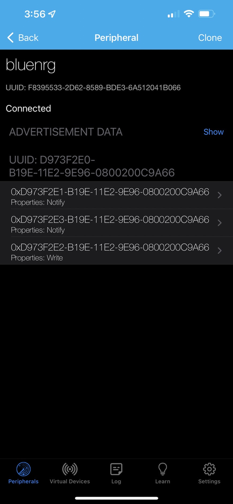

Final attached my result:
