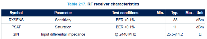

Please refer to BlueNRG-2 datasheet, table 217.
2020-09-29 11:52 PM
I have seen this one. But not sure what trace impedance to use since the impedance mentioned in the table is a complex impedance.
