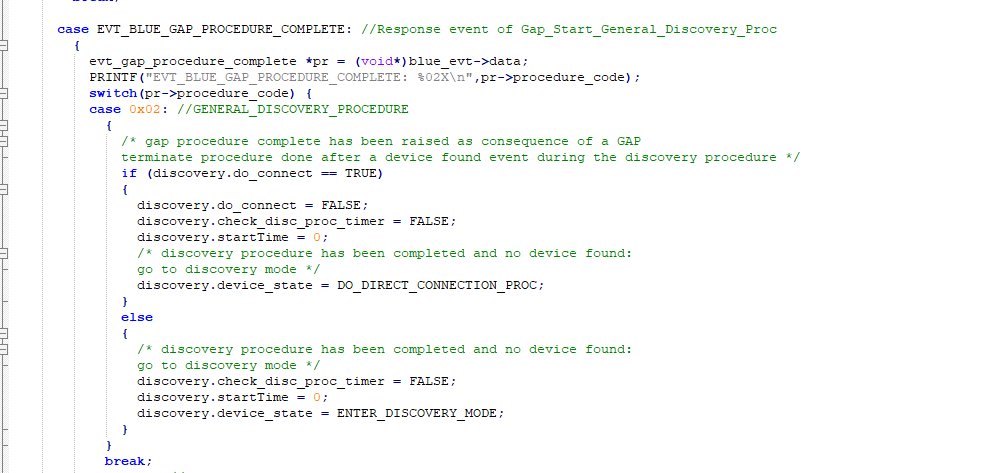

I have checked the project BlueNRG-MS_New_Chat from the BlueNRG-DK and I saw something strange in it.
It is said that Procedure Complete Event proc only when a GAP Terminate is done. So nom I'm a bit confused.
Could you explain me that ? I will share the project here.
