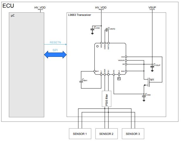

Is there any possibility to have application note of a communication between a microcontroller and a sensor (magnetic angular position sensor in my case) using a l9663 transceiver. I'm a bit lost with all the infomation in the datasheet and I need a exemple.

Hi, do you find the answer? I have a similar application case. Going throuhg the datasheet, I think L9663 doesn't support a slave function at the sensor end.

Please check: AN5366 L9663 operation in PSI5-P operation mode

L9663 only supports the "Master End". There are no "general purpose slave chips" that you can add your own sensors to. Not that I can find anywhere at least.
