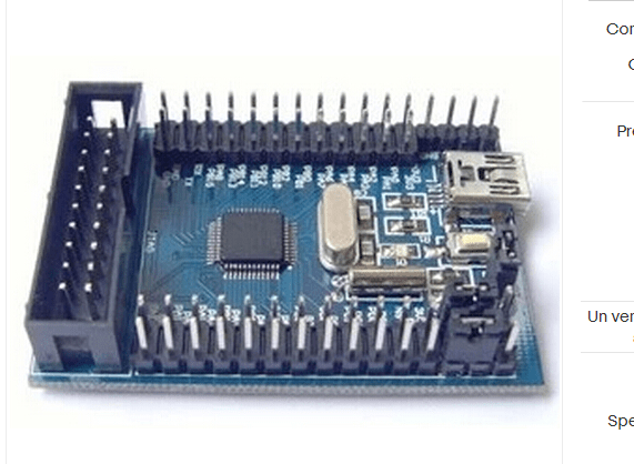

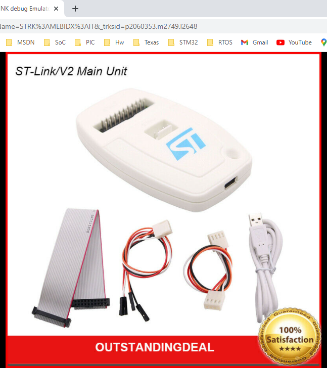

I've bought STM32F103 and St-Link/V2 and wanted to program and debug it via STM32CubeIde 1.7 . I connected the 2 devices and the laptop. I wrote a simple program
and tried to debug: I got problems. St-Link needed an upgrade, but the Upgrade tool couldn't do that because device wasn't in DFU mode. I don't know what's DFU.
I downloaded STM32CubeProgrammer and tried to update ST-Link probe: I wasn't able as I got the same answers. Nonetheless with STM32CubeProgrammer I ruined firmware

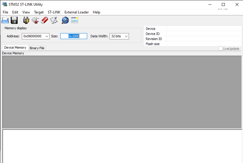

of St-Link/V2. Then I downloaded en.stsw-link009_v2.0.2 and was able to restore ST-Link original firmware. At last I downloaded en.stsw-link004_v4.6.0 and with
STM32 ST-LINK Utility I was able to update ST-Link. Now in my program, debugger executes normally. Unfortunately I have to perform the same upgrade with
STM32 ST-LINK Utility for every new project I make, but at least I saved 2 pieces of Hw.
