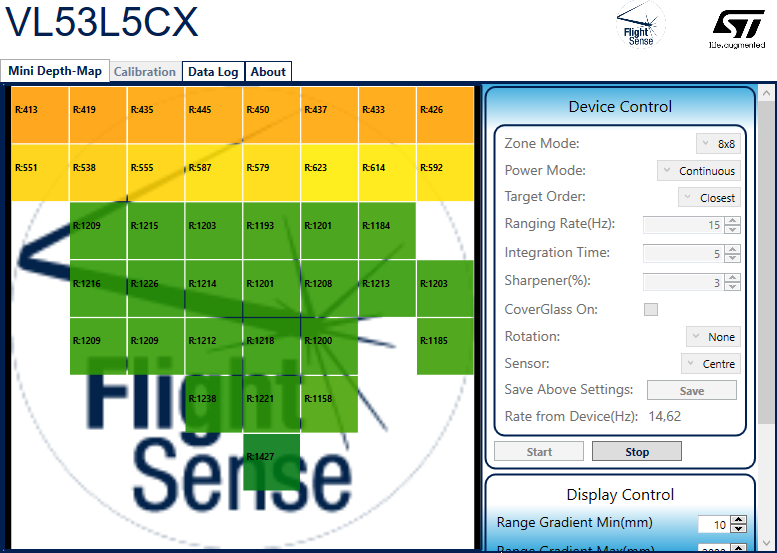

Hello @John E KVAM​ again,
I think when I use the method I explained previously the issue is that the height is only affected by the range? so if we remove a portion of the detected object the calculated height would still be the same because there were no change in range.
However, if we go back to polar coordinates like you suggested I have two questions : the first is the value of FoV of sensor, like I sent you in the link it says 63 degrees.
The second question ( as you can find in the graph attached ) is we need to determine the height ( which is Y here ) but to do so we need the value R don't we ? but we have no information about that as far as I know am I correct ? here in the 8x8 grid below, those shown values are the X values ( X as in the below graph ) aren't they ? if not how do you suggest to determine the height using polar coordinates? Thank you.0693W00000WKXT4QAP.png

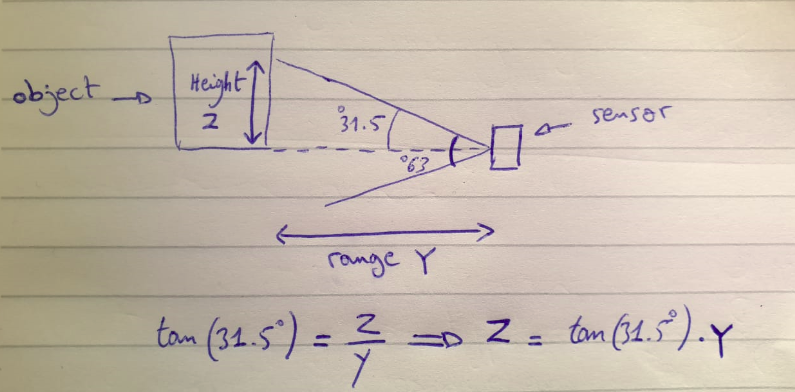

Hello @John E KVAM​ and thanks for your answer,
actually I did something similar to that and I know it gives me great results but my ultimate goal is to calculate the height of the detected object and not it's distance from the sensor that's why I first thought of the method I explained to you at first which is this
0693W00000WKaiXQAT.pngthe issue with this is that it is range dependant and only gives max height for a given range
