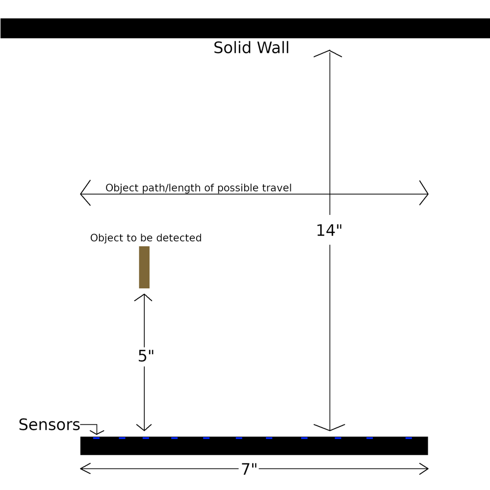

Thank you for your response.
So long as the sensors will report the closest object I believe there is a chance it will work out. I'm up for experimenting. But you do bring up a good point with the 8x8 sensor. Depending on it's field of view, that may work out very nice.
Here is a rudimentary drawing (top down view) of what i had in mind with the non-array sensors.
John E KVAM
There are 2 sensors you want to consider. Both have identical silicon, are pin compatible and the code is very nearly identical.
the VL53L5CX (L5) has a 45x45 degree field of view.
The VL53L7CX (L7) has a 60x60 degree FoV.
The L7's diffractive optics are made the same way we make silicon chips. So the L7 is a touch less expensive than the L5.
Given the FoV the L5's zones are about 5 degrees.
The L7's zones are proportionally larger.
These sensors are our most expensive, but they are less expensive that multiple single-zone sensors.
  • john
