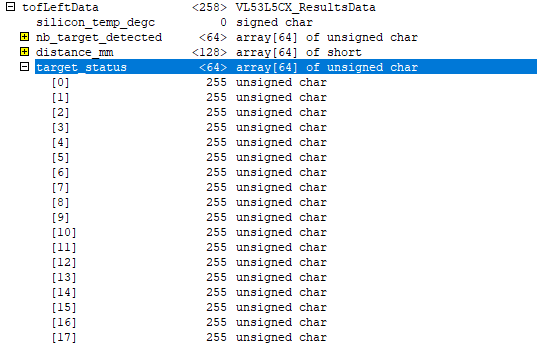

Here is a screenshot of the results
This is over multiple reads. No matter what I put in front of it, all the status is 255, and distance, nb targets, tempC, are all 0. Something is fundamentally wrong, I went back (again) and checked my wrbyte rdbyte functions. Seems all in order. Multi reads and writes seems okay too. To avoid buffer issues on the reads I do a single byte read for the number of bytes requested by the VL53L5CX ULD.

you should have a sequence number in the first byte or so. starts at 0, goes up to 255 then to 128 incrementing again to 255. Do you get that?
There has to be something wrong with your I2C. Looks like you are reading data - or the laser would not fire after the first couple of times, but you are not getting good values.
Do you get anthing in the rest of the structure?
Try putting a known constant in your structure and see if it changes.
I don't think those 255s are coming from the sensor.
Maybe a scope on the I2C.
Something is fundimentally wrong.

I can confirm the sequence number works as you say. Starts at 0 and goes up to 255, and starts back up at 128. More specifically, it goes back down to 127. Not sure if that's significant. I get nothing in the rest of the structure.
Before the sensor initialises, I have set the 'silicon_temp_degc' value to 100. As soon as I get a ranging measurement, the value resets back to 0. Further debugging with a logic analyser on the I2C bus, reveals that different data is being sent back each time. Definitely not all, 0s and not all 1s.
When I step through the get_ranging_data() function, I can see that for some reason the variable "msize" is 0 the a lot of the time. meaning that no data is being copied from the temp_buffer, into the results data. Secondly, it seems that the"block_headers" don't match the ones defined in the vl53l5cx_api.h file. Stepping through the for loop in get_ranging_data(), I stop where the block header gets assigned. the value retrieved doesn't match the block header macros in the vl53l5cx_api.h file. Example: TARGET_STATUS_BH = 0xE0840401 from, the header file. The block header received from the sensor is: 0xE0840001. we can see the 3rd hex value is different. Converting this to the block header union values, the "size" = 0, which shouldn't be the case. This comes directly from the sensor. Something is seriously awry here. I can't figure it out.
