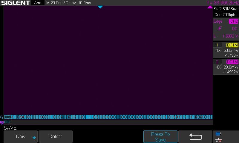

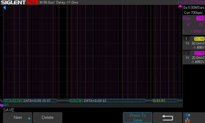

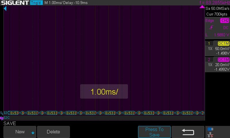

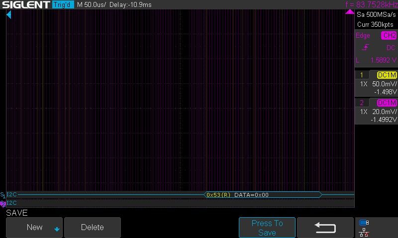

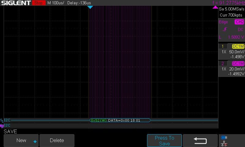

Hello Andrew,
You can delete my previous message, because I got the screen shots,
(1) no i2c_read()(1) no i2c_read()(2) no i2c_read()(2) no i2c_read()(3) no i2c_read()(3) no i2c_read()(4) with i2c_read()(4) with i2c_read()(5) with i2c_read()(5) with i2c_read()(6) with i2c_read()(6) with i2c_read()(7) with i2c_read()(7) with i2c_read()(8) with i2c_read()(8) with i2c_read()
