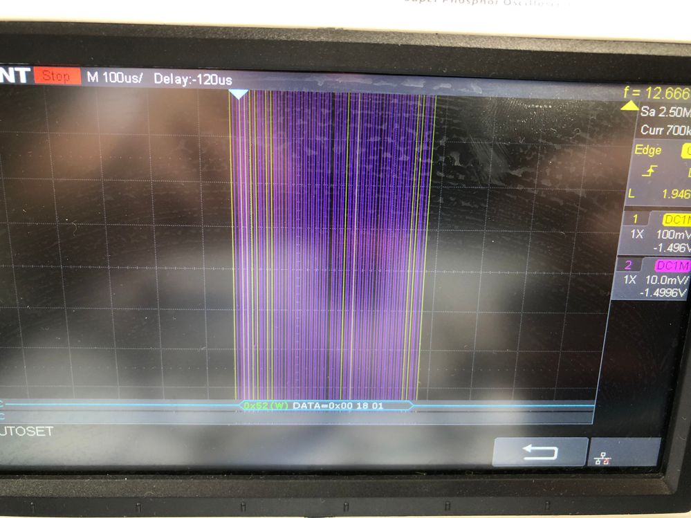

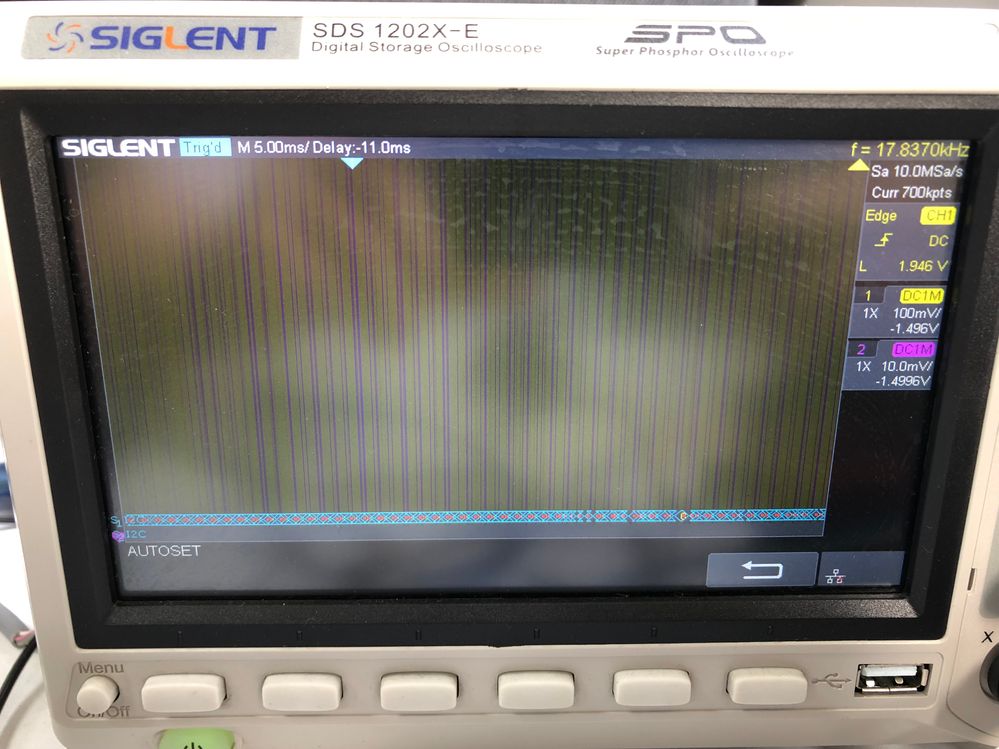

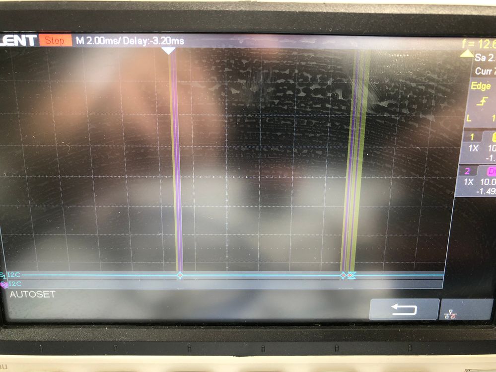

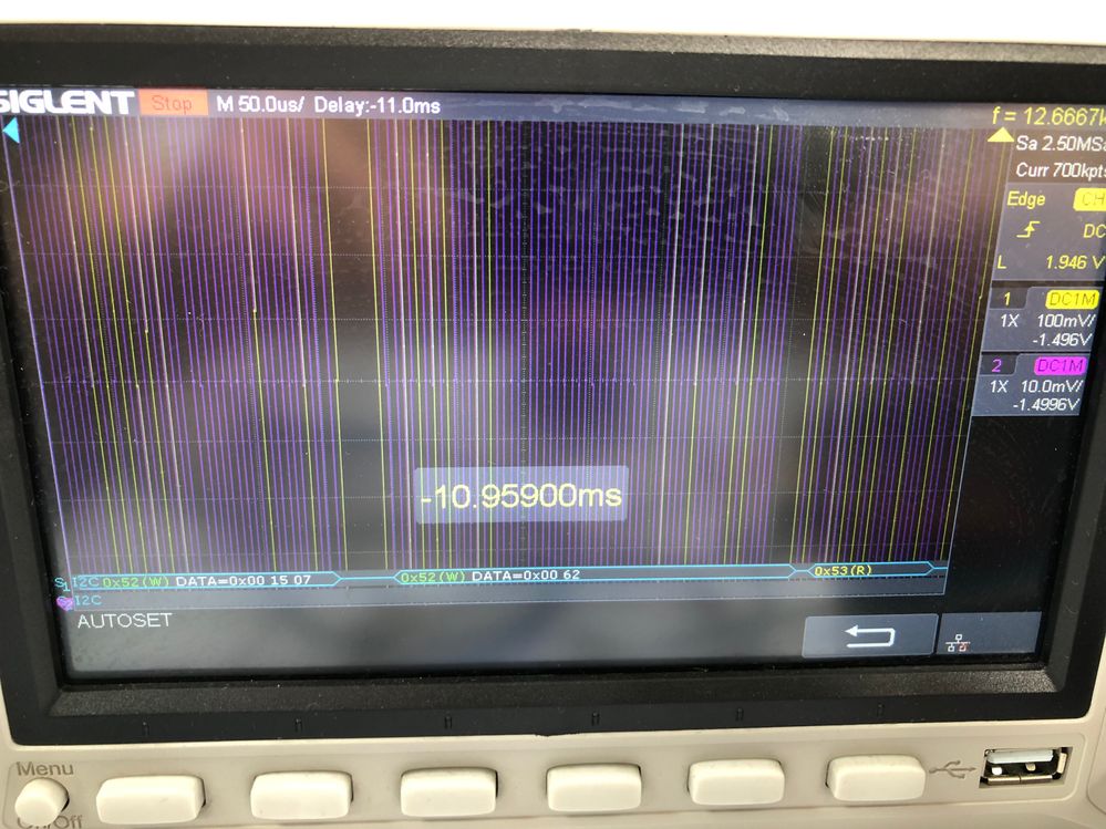

Now I will show you 4 scope photos.
If I do not use the "i2c_read()" command you see on line 24 in the code above, the messages appear as in the first 3 images. Everything seems in order.
If I use the "i2c_read()" command, things get crazy like in the 4th picture. Picture 1Picture 1picture 2picture 2picture 3picture 3picture 4picture 4

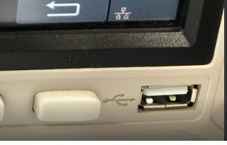

Can't you get proper screenshots via that USB socket:
That would give far better results that photos of the screen - with all that glare, etc ...
#Screenshots
Hello Andrew,
The oscilloscope only gives output in XML format, I could not take it as a screenshot. When I looked at the XML output I didn't understand much. I can share these outputs if you want.
