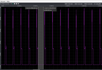

2024-07-12 2:12 AM
Sir John, thank you very much for this information. I have successfully set up the ultra low power mode, and the sensor is now consuming only a few microamps.
However, I have a question regarding the autonomous mode set to 1 Hz as described in the datasheet. According to the datasheet, between each measurement, the device should be in sleep mode, resulting in an average consumption of around 1.6 mA. However, I am observing an average consumption of 5.21 mA in this mode, as shown in the captures below. Could you please advise if there is a specific method to achieve the expected consumption between measurements?

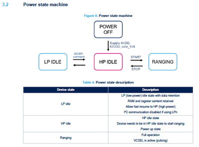

2024-07-10 9:31 AM
According to the datasheet, the power states are:
The L5 referenced a Ultra low power idle mode. Perhaps that was what you were looking for.
Between ranges you should be in LP idle state waiting for a command. I believe you can drop the LPn pin to turn off the I2C interface which saves a bit. I did not see in the datasheet if that retains the memory or not. But the chart above seems to indicate that it does. It's not very clear, however.

2024-07-12 2:12 AM
