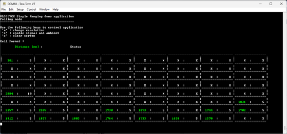

I am trying to use en.STSW-IMG037 (VL53L7CX_GUI_v2.2.29009) software to evaluate the VL53L7CX ToF sensor. I implemented firmware on the NUCLEO-H755ZI-Q board with VL53L7CX sensor from Pololu based on the firmware example in the "en.X-CUBE-TOF1\Projects\NUCLEO-F401RE\Examples\CUSTOM\VL53L7CX_SimpleRanging. I initialized the UART with 460800 baud and sensor is dumping the data on a terminal software.
The next step, I would like to use the GUI software installed in the en.STSW-IMG037 to evaluate the sensor. I launched the software, and it detect the ST-LINK. However, the "Connect" button is still graded out. Do you have any guideline how to format the serial data? Can I use the software with the board other than NUCLEO-F401RE and NUCLEO-L476RG boards?
