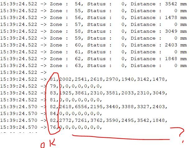

VL53L5CX works as expected when I ask for VL53L5CX_RESOLUTION_4X4. However, when I ask for VL53L5CX_RESOLUTION_8X8 not so much.
KWine
Senior
The first pixel of each of eight rows seems to provide a good range estimate in mm but the rest of the data is either zero or some huge number that doesn't respond to changes in the field of view. I assumed I would get 64 range estimates as output of Results.distance_mm[VL53L5CX_NB_TARGET_PER_ZONE*i] but that is not what I see. What am I doing wrong? Can you post a working example of 64 zone output please?

Thanks John,
The example you posted is very similar to what I am already doing and didn't change my results. However, I increased the VL53L5CX_TEMPORARY_BUFFER_SIZE  to 4096 in the vl53l5cx_api.h file as in here:
#if VL53L5CX_MAX_RESULTS_SIZE < 1024U
#define VL53L5CX_TEMPORARY_BUFFER_SIZE ((uint32_t) 4096U)
#else
#define VL53L5CX_TEMPORARY_BUFFER_SIZE ((uint32_t) VL53L5CX_MAX_RESULTS_SIZE)
#endif
and it works now. Thank you!
