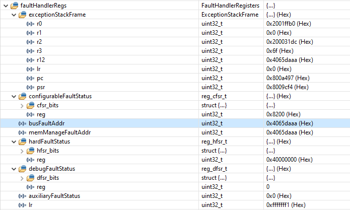

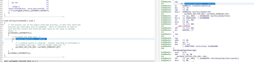

when looking at the hw registers after the crash bfsr_preciserr seems to be set and hfsr_forced is set also.
The last address of the PC was pointing to xTaskIncrementTick() .. this is from RTOS .

John E KVAM
There are muliple complied libraries for different processors.
The code is STSW-IMG035, but there is a qualifier on them for the cortex M0, M3, M33, M4 and M7
I'm guessing there is a mis-match between the ARM chip you are using and the version of the code you have. Carefully check the documentation on which chip you have and compare that to the software you've got.
Good luck,
  • john
If this or any post solves your issue, please mark them as 'Accept as Solution' It really helps. And if you notice anything wrong do not hesitate to 'Report Inappropriate Content'. Someone will review it.
Julien NGUYEN
Thanks John
I'm working with Steve directly.
The gesture lib supposes to support M4 core. The customer is using a G4 series STM32 microcontroller.
I will talk to Yann,
Bye
Julien
