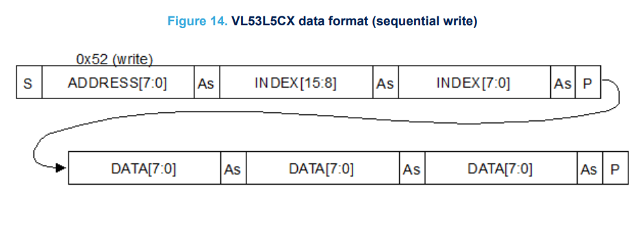

Not yet, I followed the method you did and it solved some issues for me, however I am unable to figure out how to get rid of the start bit before the data on a sequential write. How did you manage to do this?0693W00000Nqy6jQAB.pngI am getting a S|ADDRESS[0:7] before the data
Fair point, I didn't even pay that much attention to the figure. The figure is actually wrong IMO. It's a bit like a copy from the read function, but the "P" stop condition at the end of the line should not be there.
In fact, a sequential write is always just a full write procedure, where the first transmitted byte is the address+R/W, the second and third byte in this case are the register index, followed by the data to write. so this should just map onto the "i2c_write" function in i2c.h
