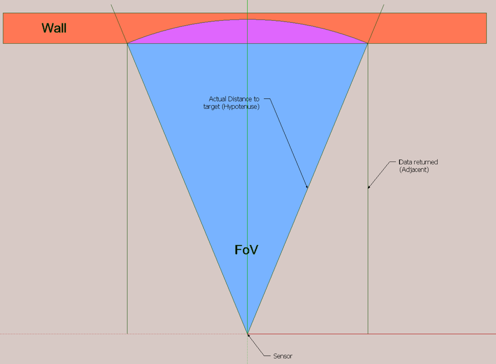

I was afraid that I missed something very critical in reading your documentation. I found that in fact I did not have the latest documents. I downloaded the newest and read every word in them. Not once do they describe this VERY CRITICAL CONCEPT you are describing!
I think any logical person would assume that taking a single laser ToF sensor and waving it around within the VL53L5CX's 45° FoV would expect it to return the absolute distance from the sensor to the object. IOW the hypotenuse. We would then use simple trig to do the 3D transformations to get the adjacent and opposite sides to place them in space. Following... more transforms would be applied to place them in a global point cloud... aka SLAM.
Why would this 8x8 sensor report data any differently?... in essence returning the adjacent side in the drawing? Thus I have to do calculations to tell ITS ACTUAL DISTANCE in case it is about to run into the wall! And more importantly, why would it not be documented ANYWHERE?

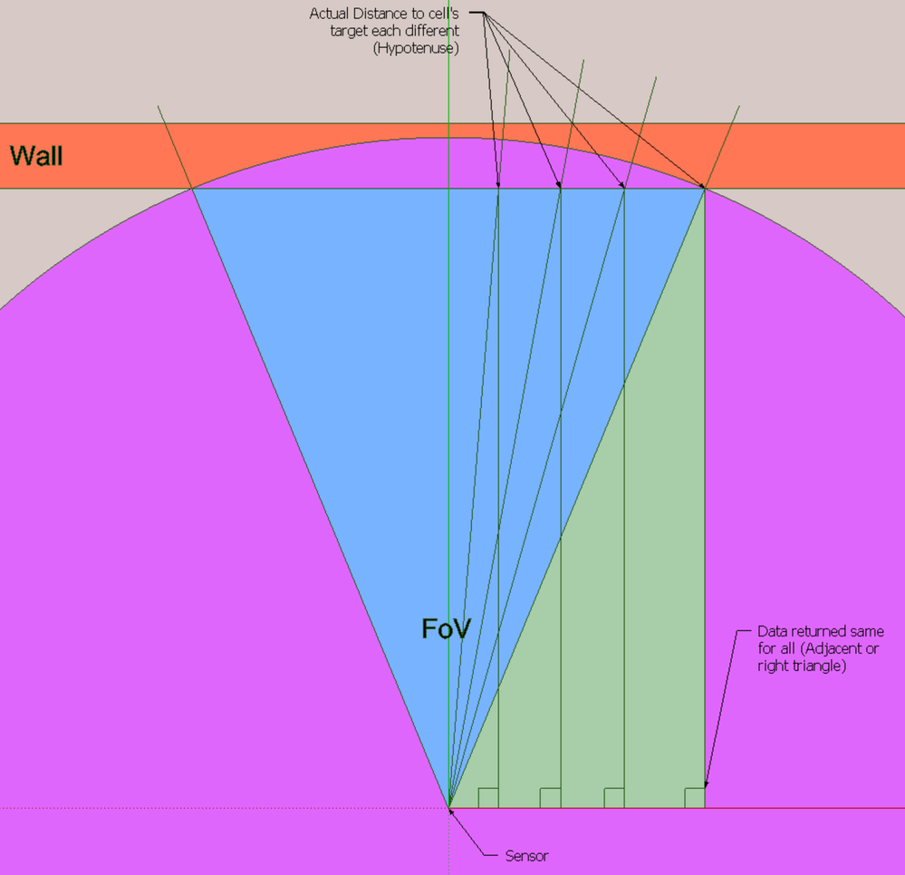

So... if all the returning distances are the same distance to a flat wall. What is that distance... the closest one, furthest one, average one? What would be the purpose of a multi-cell distance sensor that returns only the same number in this situation? In the drawing below... what would the sensor return if it is in the center of a circular room (Purple area)? I would expect it to be the same distance for all cells (+/-5%). If they are all the same, how do I know if the sensor is looking at a flat wall or a circular wall... or a spherical wall?

No... you should not get the same value. In the real world, the distances are different as you move away from the centerline. The sensor artificially correcting makes the data invalid and unusable. Please see the following posts for details of this failure.
