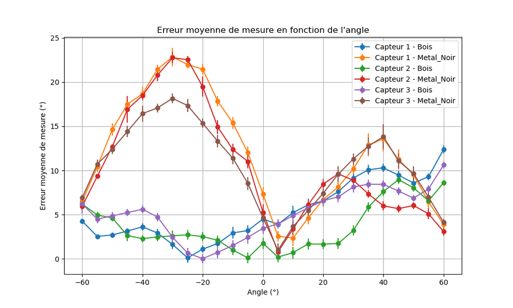

I am trying to calculate the x,y,z coordinates of each points of the VL53L5CX sensor to determine the angle error between a surface and the plan of the sensor.
I have two problem with my system :
- the resulted error is not symmetrical with one rotation side or with the other,
- and the resulted error is very depending on the material I chose.
Here is a graphic of the mean angle error with 2 surfaces (wood and black metal) repeated with 3 differents VL53L5CX (I took 50 measures each 5° degrees).
So I am wondering if my calculation of the coordinates x,y,z of each points of the VL53L5CX is right, and if I didn't forget some details. I'm almost sure that the plan calculation is right.

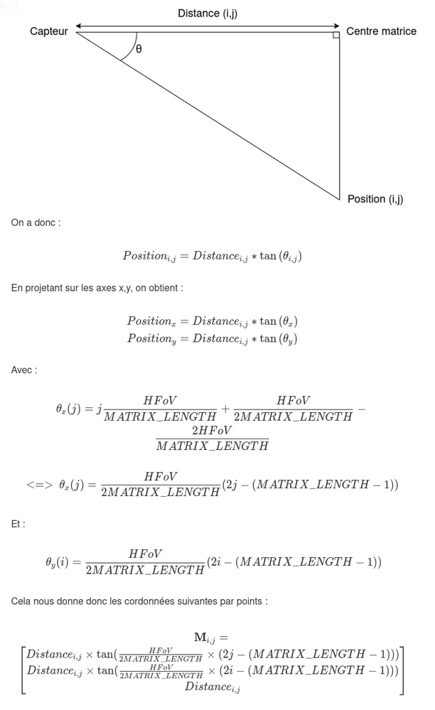

So here is the way I calculated the coordinates:

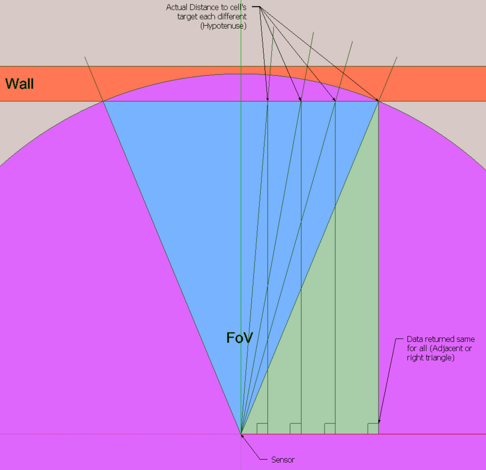

The VL53LCX give us 16points, and the returned value of each distance is the adjacent side of the FoV as said in this page of the forum : https://community.st.com/t5/imaging-sensors/vl53l5cx-distances-don-t-match-theory-what-am-i-missing/td-p/82657.

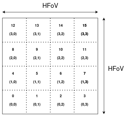

We know that HFoV = 45° and we assume that MATRIX_LENGTH = 4 (for the following calculation).
To ease the calculation we convert the 16 points in i,j columns and raws.
The calculs is detailed here:
Do you agree with this coordinates calculation, or did I miss something ?
Thank you !
Clément.

I'm a bit rushed this morning, so I did not fully understand your data. Besides my French is awful, which is pretty funny considering where I work. But I have a guess I'd like to share with you.
If you point that sensor at a flat wall exactly perpendicular, you will get the same distance in all the zones. It's because we have done a radial to perpendicular calculation to the data.
Could that be throwing you off?
As to the materials...
If you use something with a matte finish, the light will reflect in all directions. If you use a specular (mirror) finish target, the light will bounce away and depending on the angle will not return.
Please validate your targets by checking to see that the Number_of_Targets is at least 1. Then check the RangeStatus to verify that the target is valid. An invalid target can really throw off your results.
- john
2024-05-06 12:36 AM
Hi !
I guess you are right about the specular targets : when I ma using a wood surface I have almost all the number of targets at 1, but with a metalic bright surface I don't.
So just to confirm, I think that the coordinates calculation is good, but it's important to filter the points with 0 number of targets detected.
