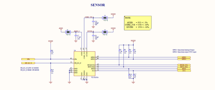

From your issue description,  issue seems more link to HW connection, can you share your connection detail and 54-ls53lx-s-l8cx schematic? make sure the AVDD, IOVDD and Core_1V8 are connected correctly.
LPn pin was pull up and SPI_I2C_N was pull down.
Reference schematic as below
