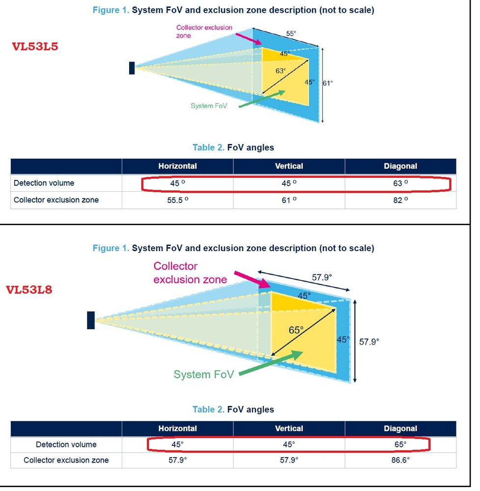

VL53L5 vs VL53L8 System field of view have or don't have different?
KennyLiew
Associate
From the above FOV diagram comparison, under the Detection Volume, why both L5 and L8 have same Horizontal and Vertical degree but different degree in Diagonal (63˚ vs 65˚)?
As I know if horizontal and vertical degree no change, the diagonal degree won't change.
Is there other parameter that take into account which make the diagonal degree is different between L5 and L8 tof sensor?

OK, ST have updated the L5 datasheet on this FOV angle to 65 degree, so L5 and L8 is same FOV now.
Case close
