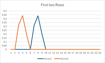

If you plot the first 2 lines of your normalized data you get:

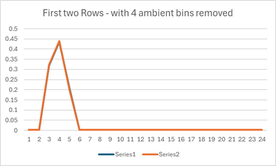

But if you understood that the first 4 bins of the 'A' ranges are ambient light values you could remove those, and your 'A' ranges will line up with your 'B' ranges.
In your data it's an exact match:
There are 4 ambient bits and 20 range bins in the 'A' ranges and 24 range bins in the 'B' ranges.
Each bin represents 20cm of range (20 bins =4M). The 'B' range has 24 bins. Looking at both allows one to look for radar aliasing (or wrap-around). When one puts a target at 4.1M, the photons from one blast will return after the photons of the next blast come out, giving an answer of 0.1M (4.1- the wrap point of 4M). But with the B range having a different number than the A range, you can detect this wrap and flag a warning.

you are a victim of poor documentation, I think. The chip designers never thought anyone would care and so they did not put much effort into this.

After reading your response yesterday, I ended up also finding a similar question on the L1 sensor. I also noticed that the same struct I mentioned contais the number of ambient bins, so it's easy to detect and automate the histogram alignment.
I also hadn't quite undestood the difference between A / B rangings and their different timings (also found on that struct) that explain the different counts but identical proportional values.
