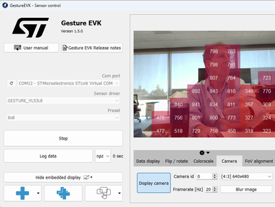

In order to find a hand, the sensor is ranging and running. And generally, there is a person behind the hand.
So, your image is going to look maybe something like this:
The posture code isolates the zones that are close - like 326. (camera is not aligned very well, but the picture is
But have a look at the zones is the darker red.
Group all the ones that are in the 750 to 850 range. I'd say that shape looks a lot like a person. And if your sensor were upside down, that shape would also be upside down.
I'd use the person's shape as your detection mechanism.
Thanks again,
- john
