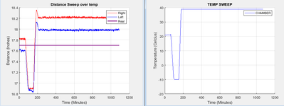

We placed two VL53L1X sensors at 18.6" in our temperature chamber.
Over a 50C swing we saw up to 1.15" of variability. In the images bellow the chamber temperature stabilized around 30 minutes.
The target was a large 24x24 sheet of white nylon 0.5" thick
The sensors were left on the entire time, polled every 10 seconds.
SPAD ARRAY size 8x8
Is there any way to improve this? Is it possible to access the temperature registers on the VL53L1x so we can create a variable to compensate for the temperature induced error?

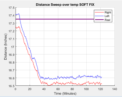

Removing line 16 shows no improvement across temperature. I assume the overshoot at the -10C to 40C transition is the temperature correction in the VL53L1x chip. However it just does not seem to be able to handle the rapid change in temp. Any further thoughts?
that data looks the same to me. Yet I'm believe you did change the thing I asked you to. And that make no sense to me.
Could you try putting line 16 back in (undoing the change) then stopping the range, re-initializing the sensor and restarting. Do that every now and again. Perhaps once per few degree changes.
It should get a little off as the temp changes and then snap back as the chip re-compensates during the init. I would think you could see it on your graph.

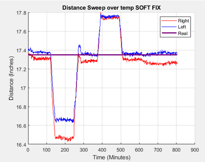

Running this test again with the software modifications, results are above. Still no change in this issue.
Our process is as follows upon first start up we initialize the sensors
Set I2C addresses
wait for sensors to boot
initialize sensors
set distance mode to short
set timing budget to 200ms
set inter measurement to 200ms
set offset cal
set xtalk cal
set ROI to 16x16
set ROI center to 199
Then we start taking measurements in 10 second intervals
Each data point we start ranging take 10 measurments, stop ranging and use the average of these as our reported distance.
If temperature changes by 5C we reinitialize the sensors using the same routine described above.
Shown in the test above we held at 20C for 2 hours dropped down to -10C at 1 degreeC per minute held this for 2 hours. Jumped up to 20C at 1C/min held this for 2 hours. Jumped up to 40C at 1C/min held for 2 hours then dropped down to 20C held at 1C/min. As you see we are still over an inch of temperature induced offset between -10 and 40C
I can run this test again by commenting out line 16 and 17 of the SensorInit function as stated before.

As shown above re-initializing the sensors showed no effect in compensating for the drift in our setup
Rebooting the sensors I haven't tried yet, looking through the API there doesn't appear to be any way to reboot the sensors over I2C? We did not implement any methods of toggling power to the sensors and XSHUT was only connected with one sensor to set the I2C Addresses.
I can run a test from room temp down to -10 and manually reset the entire setup and see where the temperature comes back too.

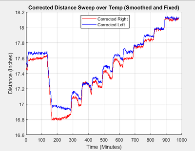

We did run a sweep shown here, starting at 20C we dropped down to -10 at 1degreeC/min then every hour we increased 5 degreeC up to 40C. The error is still outside ST's specs but appears to be relatively linear and correctable if we add a temperature sensor onto the TOF sensor board itself.
