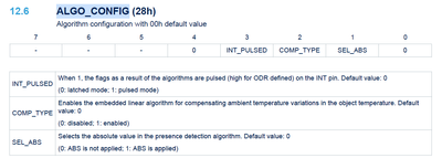

Can you try to enable the bit SEL_ABS of register ALGO_CONFIG (28h) and let me know if this solves?

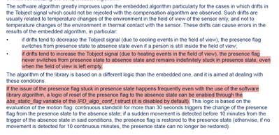

2024-09-09 11:13 PM
Hi @Federica Bossi ,
the issue is solved , thank you so much .
but ,what is the relation between presence flag stuck state when the sensor is exposed to cold object and sellecting the absolute value in the presence detection algorithm ?
2024-09-18 12:00 AM

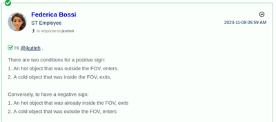

Hello, according to this conversation, your problem was that 'A cold object inside of the FOV exits'. But I don't understand why ..
Moreover, why selecting absolute value of TPRESENCE would solve detection issues ?

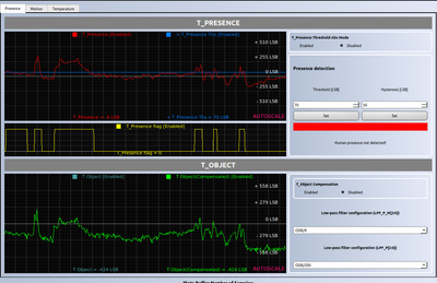

It’s been super useful since it can trace TOBJECT, TPRESENCE, and other values in real-time. It really helps to understand why sometimes we get detected and sometimes not, like in this situation :

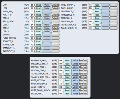

Based on the configuration I’ve been using, here’s a capture of the registers:
I’m not sure how to set the sensitivity using the InfraredPD library, but in my case, I’ve just adjusted the SENS_DATA register value. To calculate it, I looked up the lens transmittance in the lens datasheet. I found this: https://www.fresnelfactory.com/fresnel_list/en_poly_materialofFresnel.pdf , which shows transmittance based on the lens material.
